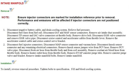

where is the knock sensor located and is it hard to replaced?
Who can show me how to replace it?
its a 2000 camaro ss 5.7 manual trans
thanks I will apreciate all your help

your vehicle's knock sensors (have two of them) are on the center of the engine, below the intake manifold. follow the steps below to remove the intake manifold and access the sensors.
https://images.2carpros.com/forum/automotive_pictures/261618_Noname_2578.jpg
