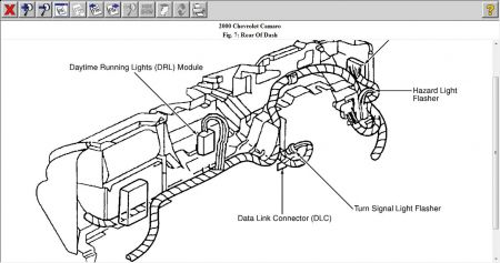

I need to know where the flasher is located.
Oct 25, 2009 at 7:42 AM
Experienced Mechanic
75,988 POSTS
The hazard flasher is behind dash, left of steering column and turn signal is behind dash right of steering column
