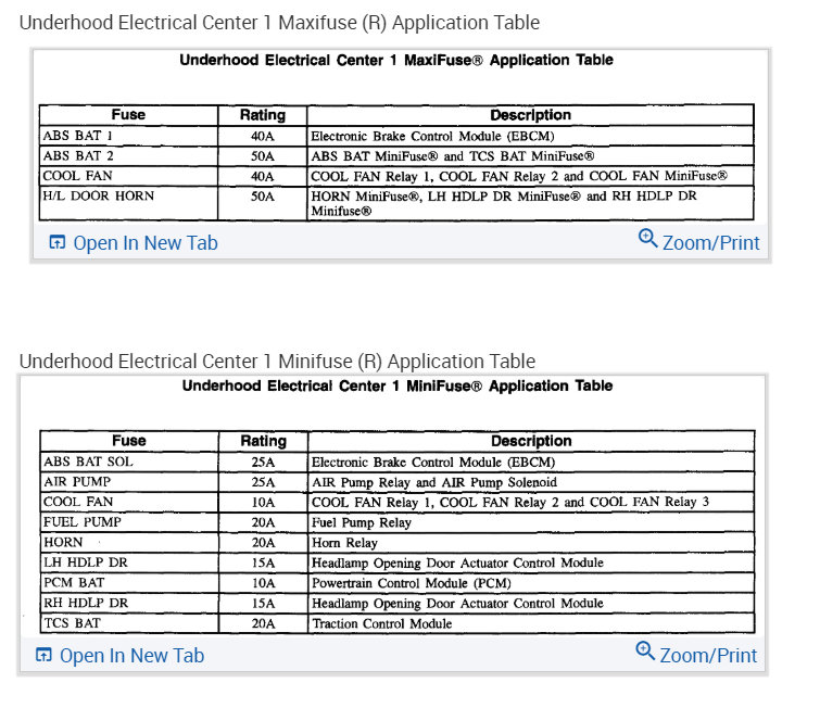

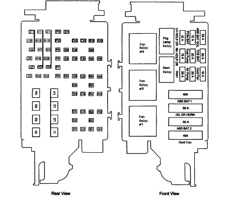

not sure what the problem is not really enough info but the filter is directly under driver sides door dont be directly under the filter that when you start this guide can help with how to test the fuel pump relay and the location on the relay in the diagrams below.
https://www.2carpros.com/articles/how-to-change-a-fuel-filter
and
Fuel Pump Relay - In underhood electrical center No. 2. Check out the diagrams (Below). Please let us know what happens.

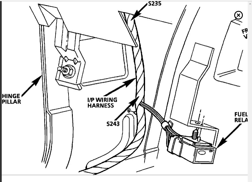

RAYMOND J
Fuel relay on 1994 Camaro Z28 is under the kick panel driver's side, square box on the floor by your left foot
Oct 21, 2020 at 11:15 AM (Merged)
  • 55,797 POSTS
Here is a diagram of its location (below) and a guide to test it.
