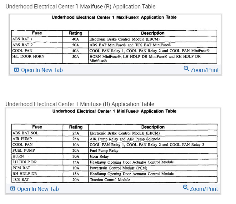

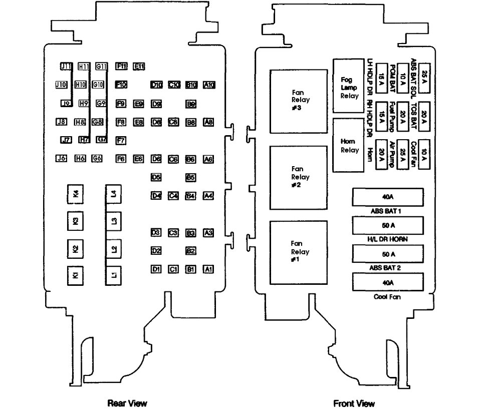

not sure what the problem is not really enough info but the filter is directly under driver sides door dont be directly under the filter that when you start this guide can help with how to test the fuel pump relay and the location on the relay in the diagrams below.
https://www.2carpros.com/articles/how-to-change-a-fuel-filter
and
Fuel Pump Relay - In underhood electrical center No. 2. Check out the diagrams (Below). Please let us know what happens.

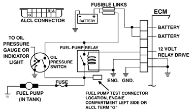

The computer energizes the fuel pump relay for 2 secs and that's it to prime the fuel system-if you're looking for power at the fuel pump connector-you're not gonna have it after that 2secs- When the engine fires up the oil pressure sending unit powers the fuel pump. see below

First check the fuel pump fuse in fuse panel in drivers' side end of dash. The relay is located behind the dash near the fuse panel, and is wired to that fuse. Pull the relay and see if it is the same as used by the fog lamps If they are the same, exchange your fuel pump relay for the fog lamp relay located under the cover of the fuse block near the air filter's location, and with the ignition key turned on, temporarily turn on the fogs. If they operate as normal, your fuel pump relay is good. It is your fuel pump electrical connections, or the pump itself that will be suspect, if the fuse and relay are good. A clogged fuel filter could prevent the fuel pump from sending fuel even if there is a signal from the PCM, just as a loose or broken wire could cause a loss of power to the fuel pump. Check those items too. The fuel filter should be replaced every 2years or 24000 miles, to achieve maximum life from the pump and fuel injectors. Sooner, if needed.

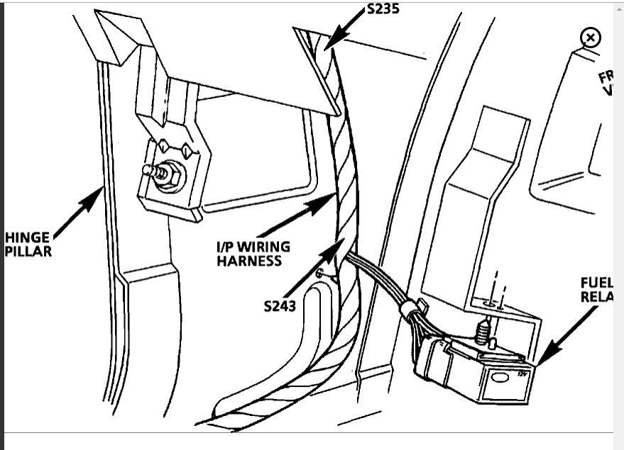

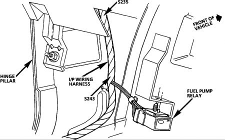

RAYMOND J
Fuel relay on 1994 Camaro Z28 is under the kick panel driver's side, square box on the floor by your left foot
Oct 21, 2020 at 11:15 AM (Merged)
  • 55,433 POSTS
Here is a diagram of its location (below) and a guide to test it.

Hello, there two sources of voltage for the fuel pump relay. Voltage for the load side of relay comes from an inline 20 amp fuse, maybe located under the hood, passenger side front, probably attached to the fender lining, you'll just have to look. The other source, for the coil side of relay comes from the pcm. This info also shows an oil pressure switch in the fuel pump circuit, once you crank it enough to bring up oil pressure, the switch closes and the pump gets voltage even without the relay. The o/p switch and load side of relay gets voltage from the same fuse already mentioned.

The other source, for the coil side of relay comes from the pcm. This one will be coming from the PCM dark green wire ckt 465 that powers the coil side from there it will power the gray that goes to the fuel pump when the switch side close. The OPS is the additional power when the engine cranks and build up oil pressure above 4psi.
https://images.2carpros.com/forum/automotive_pictures/12900_oil_sending_unit_and_fuel_pump_circuit_95.gif

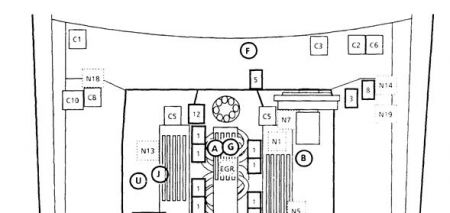

JDL
  • 16,098 POSTS
Welcome to the forum, I'd use a gage and check fuel pressure. Voltage to the injector/s goes hot when you turn the key on, the computer pulses the ground to open and close injector, engine cranking.
https://images.2carpros.com/forum/automotive_pictures/170934_camaro_fuel_pump_relay_1.jpg
The fuel pump relay is underhood, driver side firewall, C3 in the picture.
