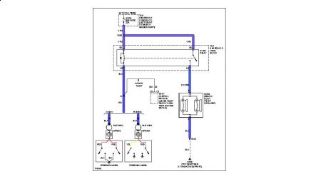

Normally i know what to do with my car, but i never learned the horn. its been randomly going off and wont stop. i have no idea what to do, any ideas?

Its either the power circuit to the horn button switch is shorting out or the switch itself to include a sticking horn relay
https://images.2carpros.com/forum/automotive_pictures/12900_horn_2.jpg

is there a chance of you sending me a bigger picture. i cant read it or see it very well
