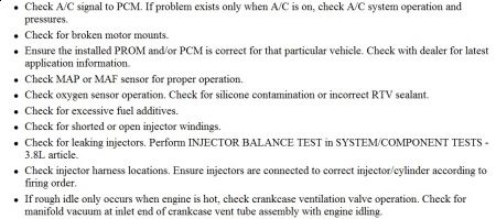

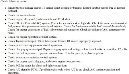

Hi, I guess I'd have to look at it. Below is a list of no code diagnostics.
https://www.2carpros.com/forum/automotive_pictures/170934_no_code_diagnostics_1_1.jpg
https://www.2carpros.com/forum/automotive_pictures/170934_no_code_diagnostics_2_1.jpg
https://www.2carpros.com/forum/automotive_pictures/170934_no_codes_diagnostics_3_1.jpg
