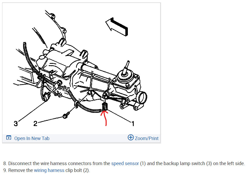

how to replace the vehicle speed sensor

Hello, I'm not sure if you can read that, it's for a 5 speed manual?

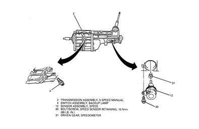

Here is the location of the vehicle speed sensor. Check out the images (below). Let us know if you need anything else.
