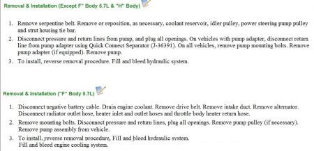

How do I pull the power steering pump from a 1998 Z28 camaro?

https://images.2carpros.com/forum/automotive_pictures/261618_Noname_2755.jpg
