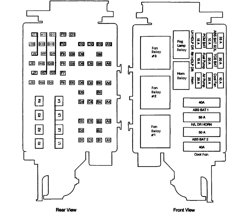

not sure what the problem is not really enough info but the filter is directly under driver sides door dont be directly under the filter that when you start this guide can help with how to test the fuel pump relay and the location on the relay in the diagrams below.
https://www.2carpros.com/articles/how-to-change-a-fuel-filter
and
Fuel Pump Relay - In underhood electrical center No. 2. Check out the diagrams (Below). Please let us know what happens.

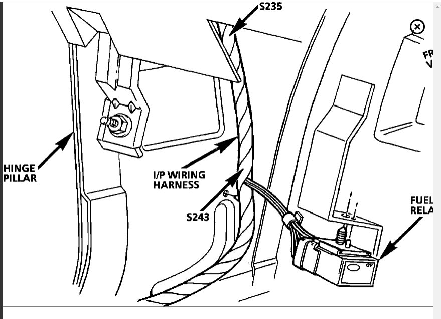

CPT87GN
  • 8 POSTS
im having trouble locating the fuel pump relay on my 1994 chevy camaro v8 and how do i check it ito see if its bad im not getting power to the fuel pump
Oct 21, 2020 at 6:15 PM (Merged)
4THGENZ28
  • 10 POSTS
First check the fuel pump fuse in fuse panel in drivers' side end of dash. The relay is located behind the dash near the fuse panel, and is wired to that fuse. Pull the relay and see if it is the same as used by the fog lamps If they are the same, exchange your fuel pump relay for the fog lamp relay located under the cover of the fuse block near the air filter's location, and with the ignition key turned on, temporarily turn on the fogs. If they operate as normal, your fuel pump relay is good. It is your fuel pump electrical connections, or the pump itself that will be suspect, if the fuse and relay are good. A clogged fuel filter could prevent the fuel pump from sending fuel even if there is a signal from the PCM, just as a loose or broken wire could cause a loss of power to the fuel pump. Check those items too. The fuel filter should be replaced every 2years or 24000 miles, to achieve maximum life from the pump and fuel injectors. Sooner, if needed.
RAYMOND J
Fuel relay on 1994 Camaro Z28 is under the kick panel driver's side, square box on the floor by your left foot
  • 54,840 POSTS
Here is a diagram of its location (below) and a guide to test it.

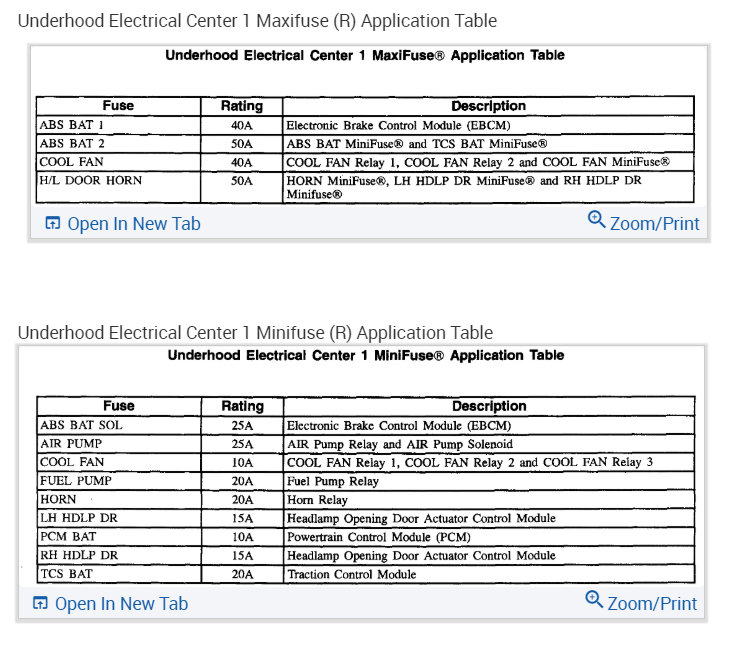

Hello, there two sources of voltage for the fuel pump relay. Voltage for the load side of relay comes from an inline 20 amp fuse, maybe located under the hood, passenger side front, probably attached to the fender lining, you'll just have to look. The other source, for the coil side of relay comes from the pcm. This info also shows an oil pressure switch in the fuel pump circuit, once you crank it enough to bring up oil pressure, the switch closes and the pump gets voltage even without the relay. The o/p switch and load side of relay gets voltage from the same fuse already mentioned.
