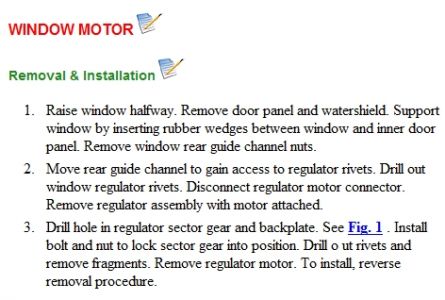

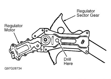

I need step by step instructions for replacing the window motor and regulator for my camaro. Thanks.

https://images.2carpros.com/forum/automotive_pictures/261618_Noname_2432.jpg
https://images.2carpros.com/forum/automotive_pictures/261618_Graphic_603.jpg
