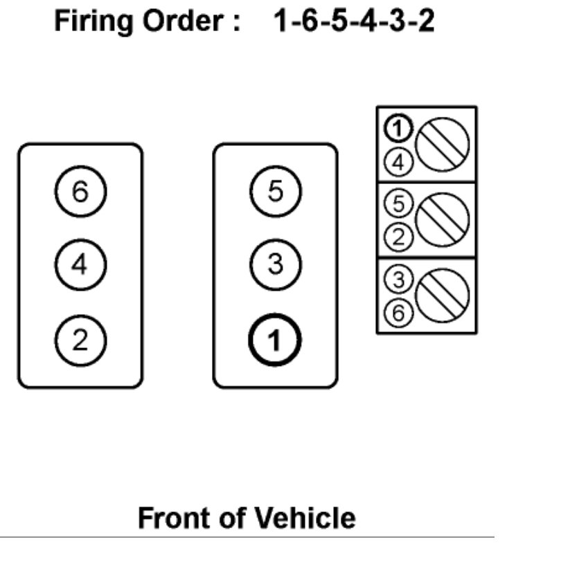

Engine Performance problem 6 cyl Two Wheel Drive Automatic 120000 miles
hi, i just got my spark plugs and wires changed and it doesnt drive like it use to and feels like it might be in the wrong firing order but i dont know. any advice or suggestions?
Mar 13, 2010 at 5:14 AM
  • 55,423 POSTS
Hello, Here is the firing order after you have changed you spark plug which we have a great guide on here: https://www.2carpros.com/articles/how-to-change-spark-plugs Firing Order 1-6-5-4-3-2
https://images.2carpros.com/forum/automotive_pictures/12900_fo_98.jpg
(LARGER IMAGES BELOW) Please use 2CarPros anytime, we are here to help. Please tell a friend. Cheers, Ken

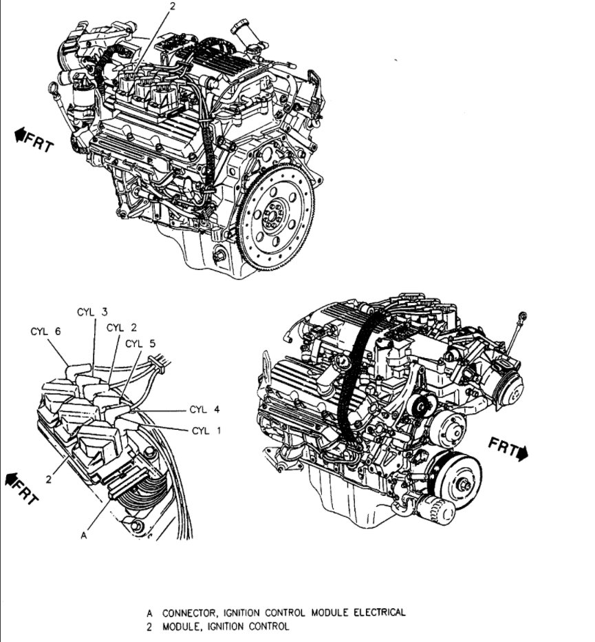

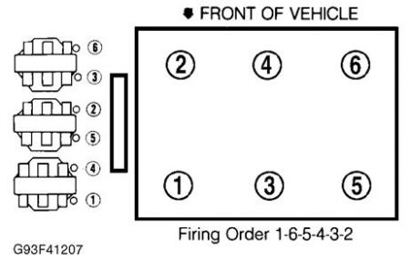

1996 Chevy Camaro 6 cyl Front Wheel Drive Automatic 120000 miles
i think is 246135 but not sure
Oct 3, 2017 at 3:34 AM (Merged)
2CARPRO JACK
  • 11,533 POSTS
here ya go
https://images.2carpros.com/forum/automotive_pictures/1639_camaro_1.jpg
