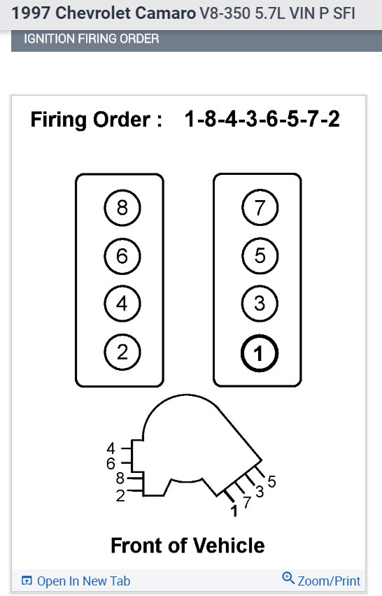

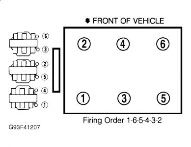

Do you have a picture of the correct wire harness form the ignition coils to each spark plug

Depends on engine size and body type. 3.8L engine , diagram is below.
https://images.2carpros.com/forum/automotive_pictures/261618_Graphic_188.jpg
The V8 firing order is below. Check out the diagrams (Below). Please let us know if you need anything else to get the problem fixed. Cheers, Ken
