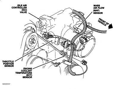

The cooling fans on my 97 camaro won't turn on when overheating. It has had the radiator,waterpump, and termostat replaced. what could be the problem other then the relay fuses?

Engine coolant temp sensor under throttle body
https://images.2carpros.com/forum/automotive_pictures/198357_Graphic_181.jpg

Dumb question but did u check for power and ground at the fans?
