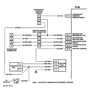

Measure voltage from ICM terminal "B" and ground is it between 1-4V?
https://images.2carpros.com/forum/automotive_pictures/198357_Graphic_705.jpg

hey can u send me the direct link to that schismatic so i can enlarge it and save it for future reference.
Nov 9, 2010 at 3:23 PM
DOCFIXIT
  • 18,828 POSTS
Nope but you can go to Repair Manuals on this site and get entire manual from Mitchell on Demand @ $10

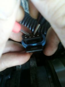

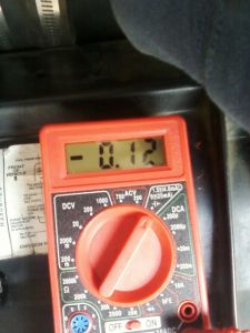

I got a weird reading of -0.12 on the meter disclosed in photo
https://images.2carpros.com/forum/automotive_pictures/590619_111010121356_1.jpg
https://images.2carpros.com/forum/automotive_pictures/590619_111010121222_1.jpg
https://images.2carpros.com/forum/automotive_pictures/590619_111010121337_1.jpg
if i am at a wrong setting or on the wrong connectors please let me know. Key is in On position.

Meter needs to be on 20 scale DCV

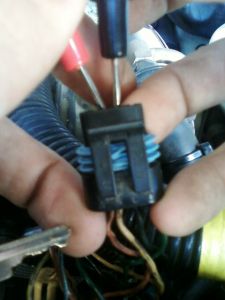

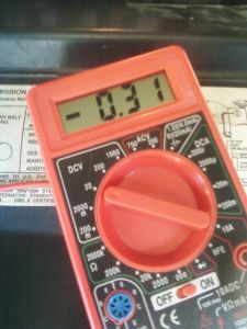

https://images.2carpros.com/forum/automotive_pictures/590619_111010132914_1.jpg
and this number jumped around from -.35 to -.29

Check from B to engine bolck if voltage then ground C black mis faulty
