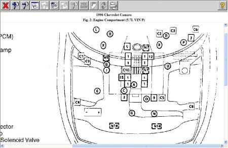

Where are the three oil sensors located. I have replaced the low oil level sensor and one other sensor that I believe went to the pump. I need the location for the sensor that goes to the oil gage. If you have a picture or diagram that would work. Thank you
May 5, 2008 at 6:28 AM
  • 75,992 POSTS
All you got is the oil level sensor and the oil pressure sensor that's located on top rear of engine near intake manifold. See item no. N7 below
