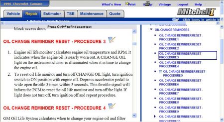

I have a 96 camaro. the service engion light and oil lights are on. I need them off to smog it. I changed all the oil and tranny fluid so i dont know why the oil light and engine lights wont turn off. if you could give me some suggestiions that would be a great help. Also i was told there is a reset button but i dont see one.

What you need to do here is get the computer scanned for OBD2 code/s to find out what's causing the light to come on. Oil light on-check the oil pressure with a mechanical gauge if normal replace the oil pressure switch abnormal could mean oil pump and engine bearings Resetting oil light see below
https://images.2carpros.com/forum/automotive_pictures/12900_oil_light_reset_1.jpg
