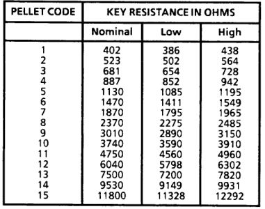

Here is the diagram and all the possible resister values
https://www.2carpros.com/forum/automotive_pictures/561653_Passkey_wiring_96_Camaro_1.jpg
https://www.2carpros.com/forum/automotive_pictures/561653_passkey_pellet_chart_1.jpg
Saturday, September 18th, 2010 AT 11:27 AM
CASEYMILLER89
  • 7 POSTS
The ohms reading on my key is a 2.9 and it is not on the chart that you sent to me
Saturday, September 18th, 2010 AT 11:51 AM
WRENCHTECH
  • 20,761 POSTS
Then either the key is no good or your reading it incorrectly. Are you sure it's not 2.9K
Saturday, September 18th, 2010 AT 1:35 PM
