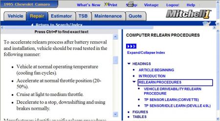

install a new ecm has the vin number need to know the relearn proccess
Feb 27, 2009 at 5:39 PM
  • 75,992 POSTS
It needs a Tech1/2 scan tester or do below and see what happens
https://images.2carpros.com/forum/automotive_pictures/12900_relearn_2.jpg
