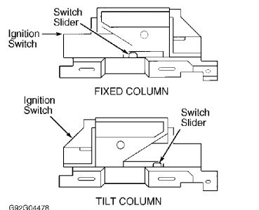

I have no power to the dash but eveything else works(lights, radio, heater, seats) but when the key is turned on there is nothing to the dash no gauges no CEL light and the car wont turn over.
I have checked all the fuses, the ones in the engine bay and the ones inside the drivers door panel.
Please help ASAp
Thanks

IGNITION SWITCH ADJUSTMENT 1. Set key lock cylinder in OFF-LOCK position. On fixed column, set ignition switch slider (where actuator rod connects to switch) to the OFF-LOCK position by moving slider to left as far as possible and then one detent to right. See Fig. 4 . 2. On tilt column, set ignition switch slider (where actuator rod connects to switch) to OFF-LOCK position by moving slider to right as far as possible, and then one detent to left. See Fig. 4 . 3. Install switch. Tighten switch screws to 35 INCH lbs. (4 N.m). Ensure ignition switch functions properly with lock cylinder in all positions. Fig. 4: Adjusting Ignition Switch Courtesy of GENERAL MOTORS CORP. CAUTION: New ignition switch is pinned in the OFF-LOCK position. Plastic pin must be removed before operating switch. Page 1 of 1 STEERING COLUMN SWITCHES -1994 Chevrolet Camaro 2/22/2009
