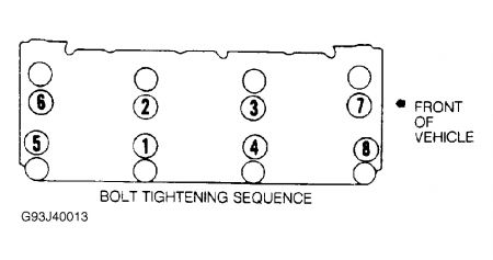

3.4 liter engine, how tight should they be? do they need to be replace while i change the head gaskets? what other parts need to be replaced at this time?

Installation 1.Clean cylinder head bolt threads and cylinder block holes. Install gasket on cylinder block. Ensure all holes align with cylinder block. 2.Install cylinder head. Apply GM Sealant (1052080) to head bolt threads, and install bolts. Tighten cylinder head bolts in sequence to 41 ft. lbs. (55 N.m). 3 . Tighten bolts in sequence an additional 90 degrees using Cylinder Head Bolt Wrench (J-36660). 4.To complete installation, reverse removal procedure. Tighten nuts and bolts to specification. Fill cooling system
https://images.2carpros.com/forum/automotive_pictures/99387_Graphic1_37.jpg
