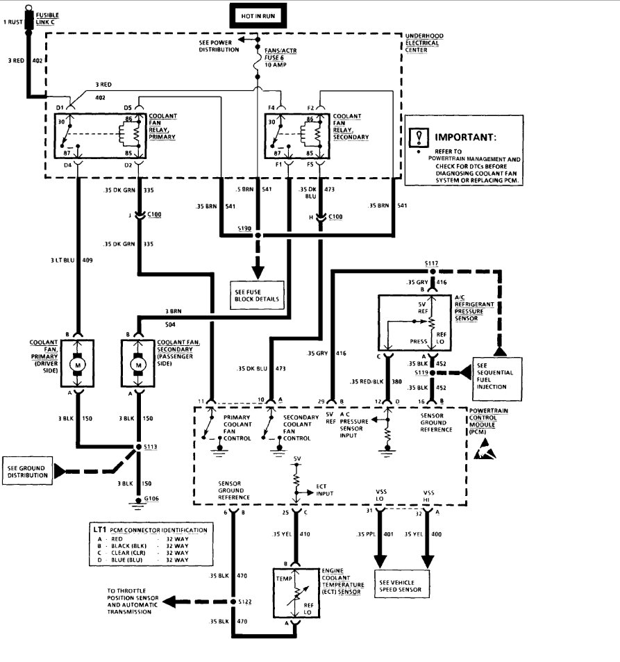

i have a 1994 camaro that when i purchased noticed the owner cut the pig tails on the cooling fans and wired direct to a switch and of course used no relays, as a temp fix i wired in some relays to make it safe and installed a fuse for them but i want to wire them back up like they were from the factory when i get home from iraq as i hate bad wiring being a previous mecp cert custom car audio tech, but i cant find a wiring diagram anywhere and i hate going blind into old wiring i am assuming the relay went bad and he was to cheap to replace so just wired in a switch but anyway any help would be greatly appreciated thank you

Here is the cooling fan wiring for you car and a guide to help you check it.
