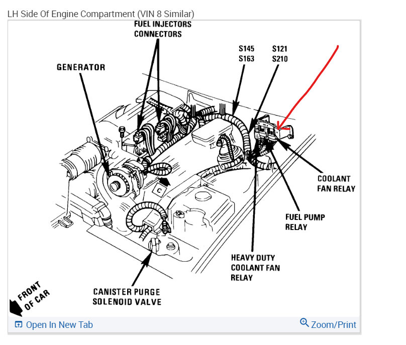

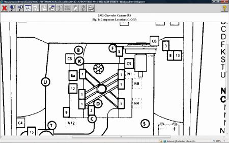

Where do I find this relay?

On the left fender apron, near the brake booster, look for #8. Check out the diagrams (Below). Please let us know if you need anything else to get the problem fixed.
Check the images below for more information.
