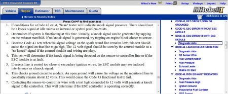

got a code 43 on my 91 camaro rs,305 tbi.it says electronic spark control.is knock sensor involved in that,i have bad idle,strong gas smell,hesitation,please help[img:cf3be6b633]http://www.2carpros.com/forum/automotive_pictures/336278_l_c0fc2698097e1206edba7a0ac1ae89b1_2.jpg[/img:cf3be6b633]

Try cleaning out the idle air control valve and test the TPS and MAP sensors
