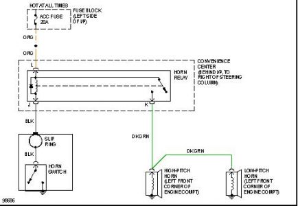

1991 Chevy Camaro V8
my horn does not work from the inside. what could it be ? I dont see a fuse for it

https://images.2carpros.com/forum/automotive_pictures/170934_chevy_horn_relay_1.jpg
Welcome, I'd check the circuits at the horn relay. The problem is usually the wiring circuit in the steering column. Did you try using a jumper to see if horn will honk?
Oct 7, 2009 at 5:44 AM
SKIPFEEDG
i jumped it from the battery
