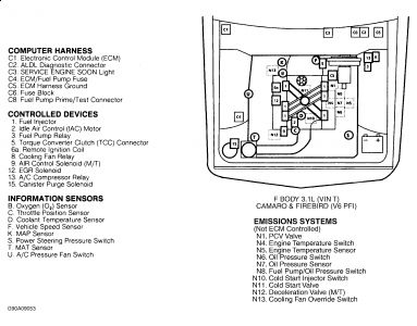

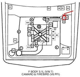

I'm suppose to replace the relay for the A/C compressor, but I'm not sure where it's located on the car. Can you help me out here?
Sep 7, 2009 at 9:25 PM
BLUELIGHTNIN6
  • 16,542 POSTS
your vehicle's A/C compressor control relay is located on the left side of the firewall, to the left of the brake booster.

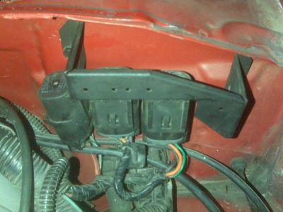

Ok, I found what you are talking about as to the three relays on the left side of the firewall, but I'm not sure which one it is. I included a picture of the setup in my car.
https://images.2carpros.com/forum/automotive_pictures/406383_IMG00294_2.jpg
Sep 7, 2009 at 9:55 PM
BLUELIGHTNIN6
  • 16,542 POSTS
should be the middle one. you can match up the OEM part number to the new relay if needed.
https://images.2carpros.com/forum/automotive_pictures/261618_Noname_948.jpg
Sep 7, 2009 at 9:59 PM
JHUERTA22
  • 15 POSTS
Well I've just tried all but one relay and the clutch on the compressor still won't engage when the A/C is turned on. When I checked the wires that ran to the compressor I had no juice from them. I figured it was the relay, but it could be a pressure valve. Any help here?
