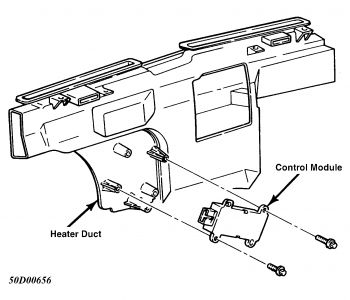

where is the BCM, and the ECM/PCM located. I believe the ECM/PCM is located on the dist. where is the bcm and what color wire is circuit 229

The ECM is behind the right side of the dash.PCM is a newer version of an ECM. That car doesnt list a BCM, you may need to get to the VAT module, it is located behind the center console attached to the heater duct (see pic)
https://images.2carpros.com/forum/automotive_pictures/1639_Graphic_2.jpg
For any wiring questions I need to know the 8th digit of the vin #
