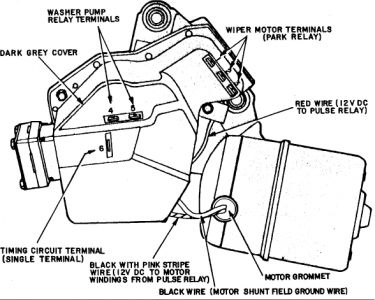

The wipers will come on most of the time. Every once in a while they won't even come on. Sometimes they won't turn off. They only go on one speed - slow. Is it the wiper motor or is there a control module? Sales person at auto parts store said there was a pulse board module for that car but they can't get it. Any suggestions?

Hello Here is the complete check out on the wiper system. See how this works for you. Also if you have to get back with us please provide your specific engine size in liter and the 8th digit of your VIN.
https://images.2carpros.com/forum/automotive_pictures/248015_1_82.jpg
WIPERS INOPERATIVE Turn ignition on and check for battery voltage at wiper motor terminal 2, Fig. 5, using a test lamp. If lamp fails to light, proceed as follows: Check wiper system fuse and replace if needed. If fuse blows again, disconnect electrical connector to motor and replace fuse. If fuse does not blow with harness disconnected, repair or replace wiper motor. If fuses continue to blow with harness disconnected, or if fuse was satisfactory (step a.), repair feed circuit to wiper motor. If lamp lights in step 1, check for battery voltage at motor terminal 1. If lamp fails to light, check terminal board connections and repair as needed. If connections are satisfactory, gearbox relay is defective. Place wiper switch in low position, disconnect electrical connector to gear box relay and connect test lamp between terminals 1 and 2 in connector. If lamp fails to light, check continuity of wiring between motor and switch, switch continuity and ground, and repair as needed. If lamp lights in step 5, place wiper switch in high position, disconnect electrical connector to pulse timer and connect test lamp between terminal 6 in timer connector and terminal 2 in gear box relay connector. If lamp fails to light, check continuity of wiring between motor and switch, switch continuity, and repair as needed. If lamp lights in step 7, remove washer pump and reconnect electrical connectors to wiper motor. With wiper switch in low position, check for battery voltage at red wire to pulse relay, using a test lamp. If lamp fails to light, replace gear box relay. If lamp lights, connect test lamp between pulse relay yellow wire and ground. If wipers operate, replace pulse timer assembly. If wipers do not operate, check for battery voltage at pink/black wire to pulse relay, using test lamp. If lamp fails to light, replace pulse relay. If lamp lights, repair or replace wiper motor.

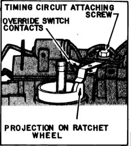

WIPERS WILL NOT SHUT OFF Crank Arm Rotates 360 ° Operate wipers with switch in delay position. If wipers operate properly in delay position, proceed as follows: Place wiper switch in off position, disconnect electrical connector to gear box relay, and connect test lamp between terminals 1 and 2 in connector, Fig. 5. If lamp lights, check for grounded wire between motor and switch or defective switch, and repair as needed. If lamp does not light, remove washer pump and inspect gear box relay latch arm spring, Fig. 15. If spring is properly installed, replace gear box relay. If wipers do not operate properly in delay position, proceed as follows: Place wiper switch in off position, then turn ignition off and on. If wipers park properly, check condition and adjustment of holding switch, and repair as needed. If holding switch is satisfactory, replace pulse timer assembly. If wipers stop but do not park properly after performing step a., inspect override switch contacts, Fig. 18. If switch contacts are held open by ratchet wheel, check for grounded blue wire and repair as needed. If override switch contacts are not held open, check for loose or defective pulse timer or improperly adjusted override switch.

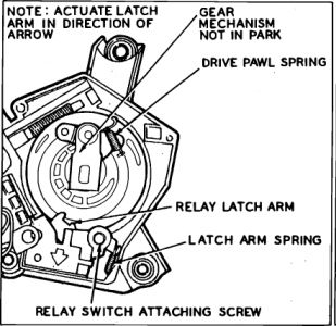

Wipers Cycle In & Out Of Park Position If wipers operate properly at low speed, check drive pawl and spring and gear box relay latch arm spring, Fig. 15. If drive pawl and latch arm springs are satisfactory, replace gear box relay. If motor does not operate properly at low speed, refer to ``Motor Operates At High Speed Only.
