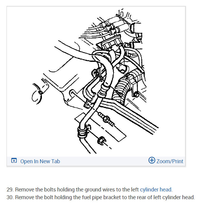

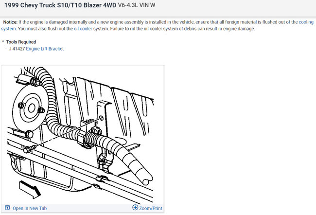

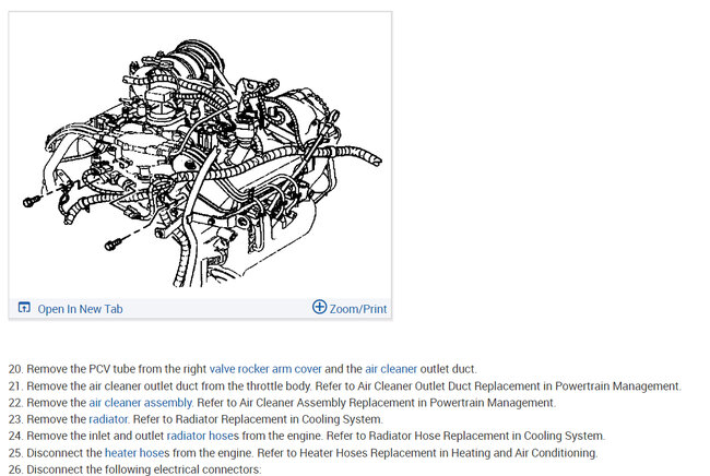

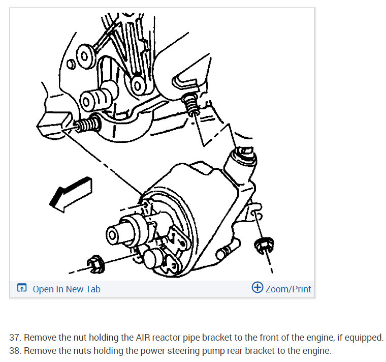

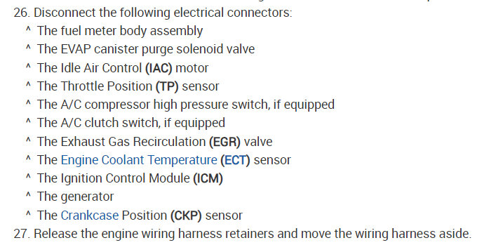

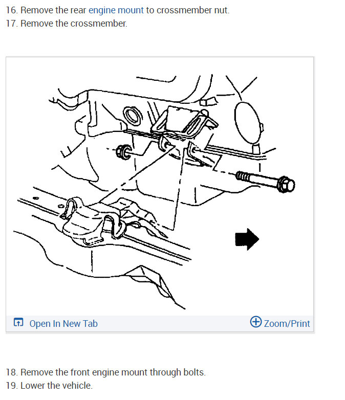

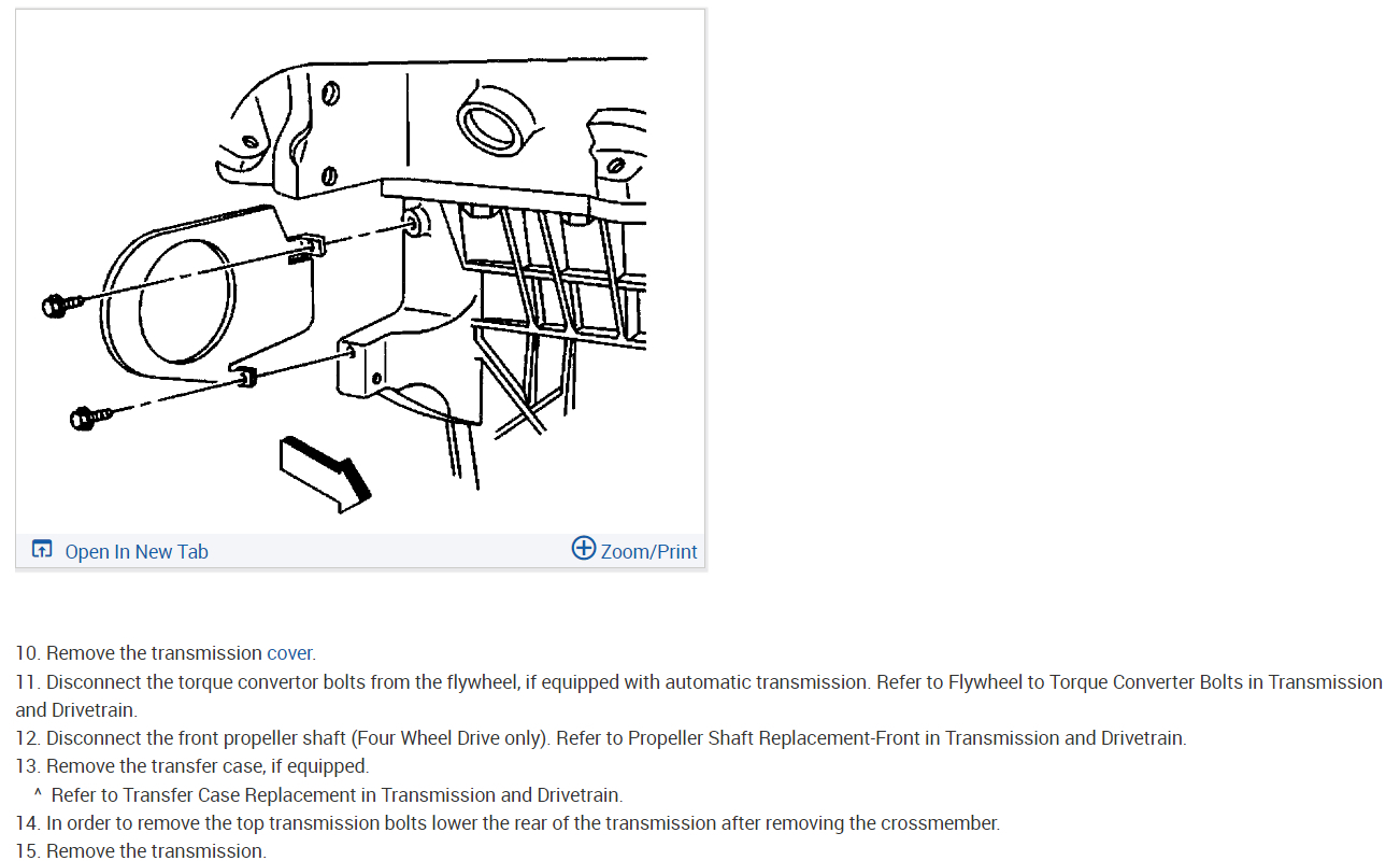

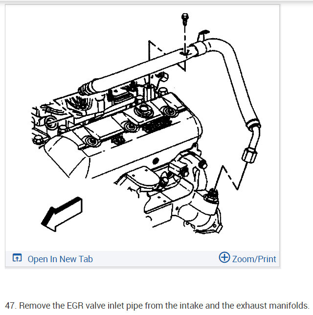

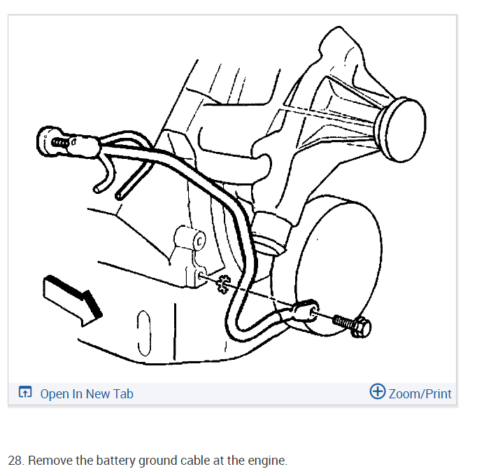

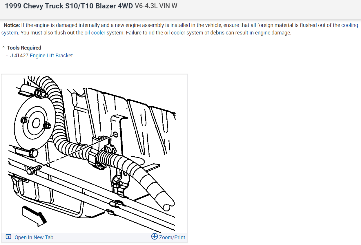

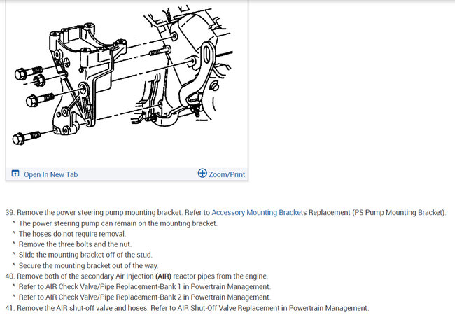

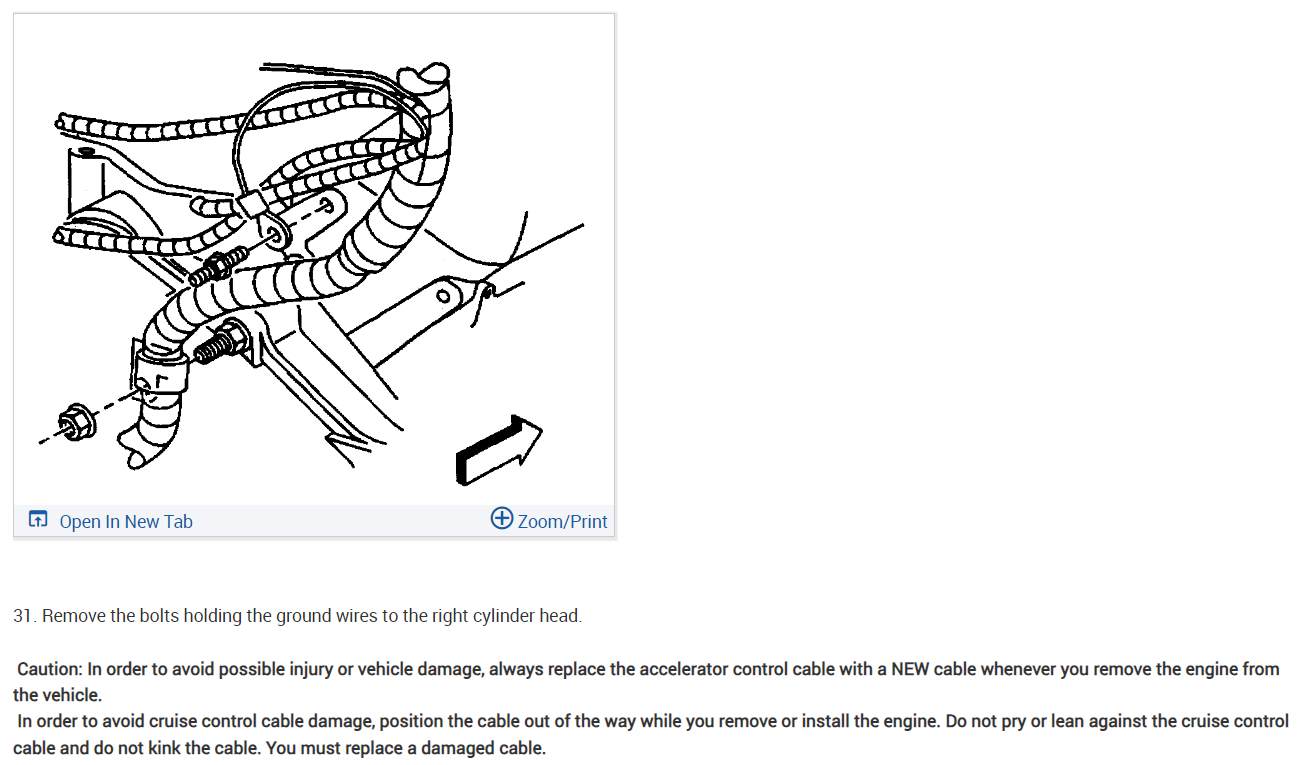

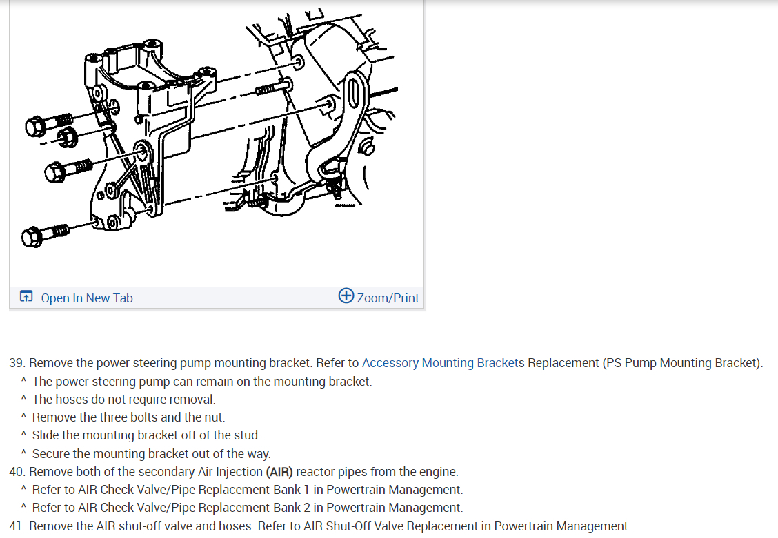

Swapping engines is not as easy as it used to be...I need some help.I get different and conflicting suggestions...some tell me to take old engine out I must unbolt the front body mount bolts? And remove the transfer case? And front drive axle?....Is there a video on this??? How many and where are the front body mount bolts???
Nov 14, 2007 at 6:10 AM
DENNYP
  • 1,824 POSTS

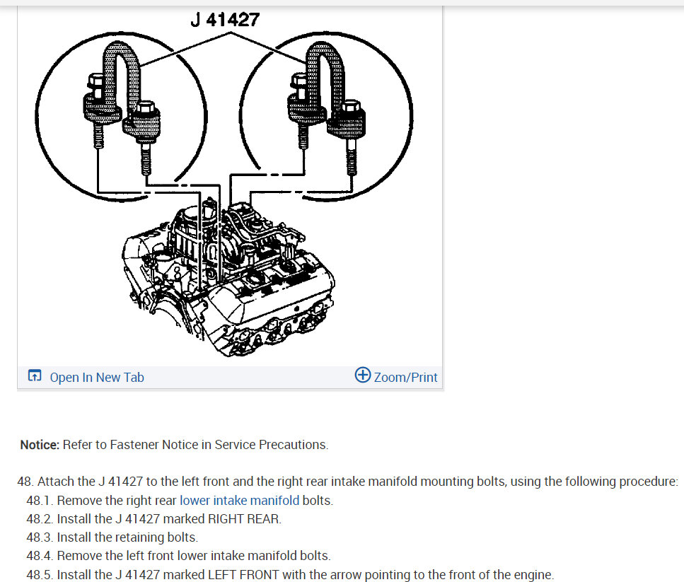

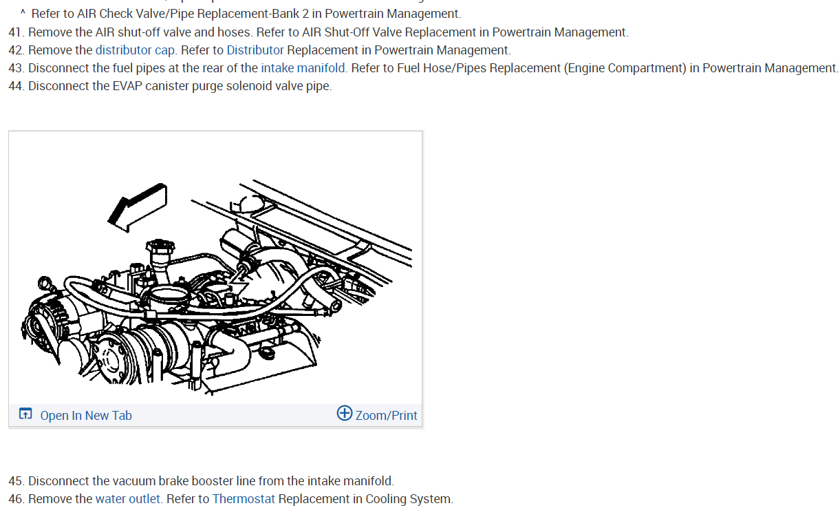

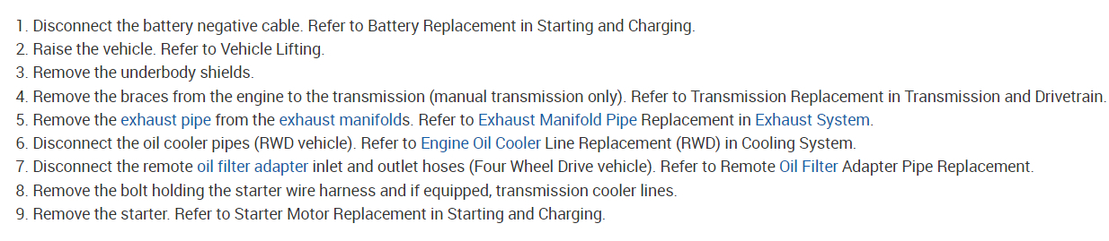

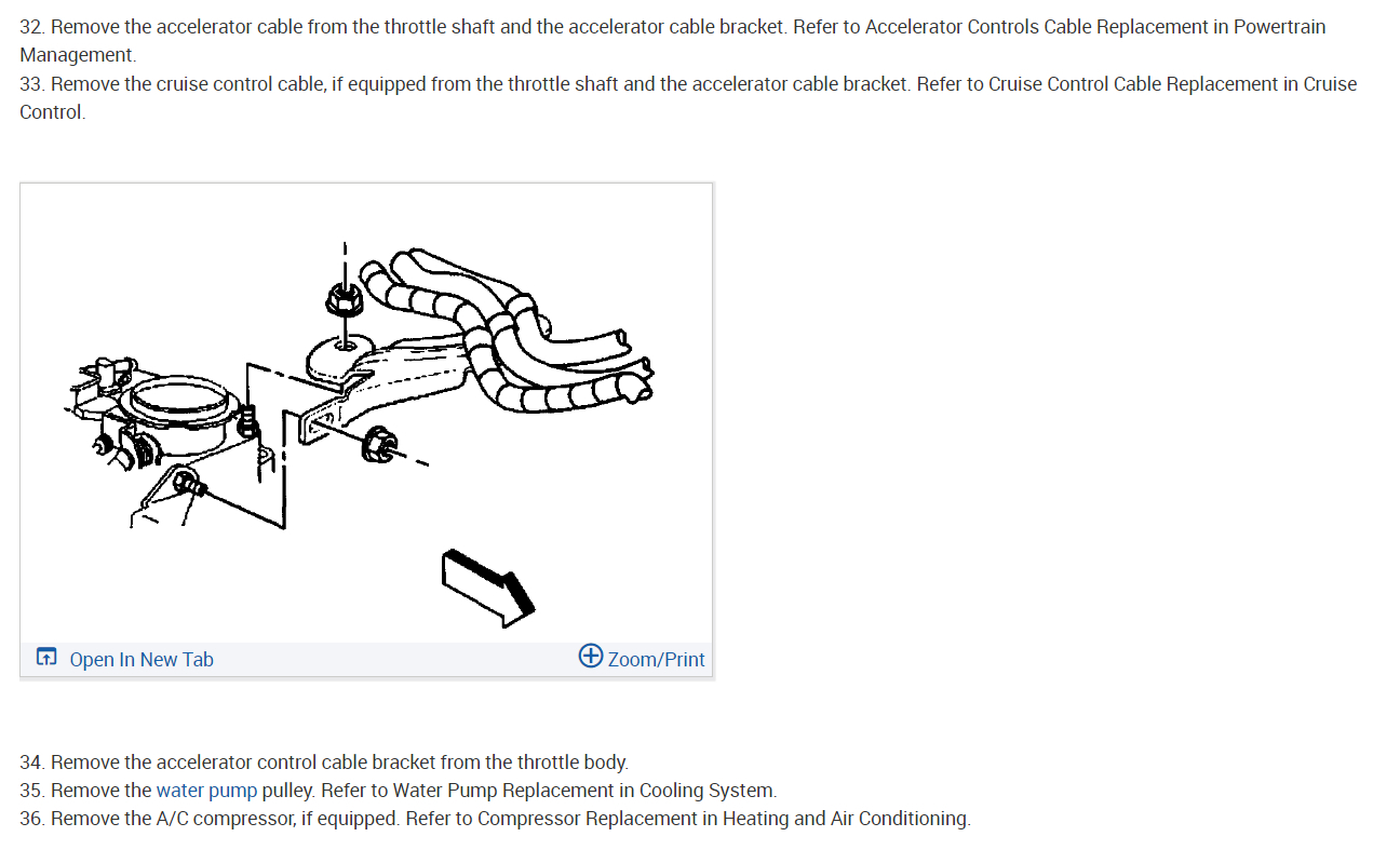

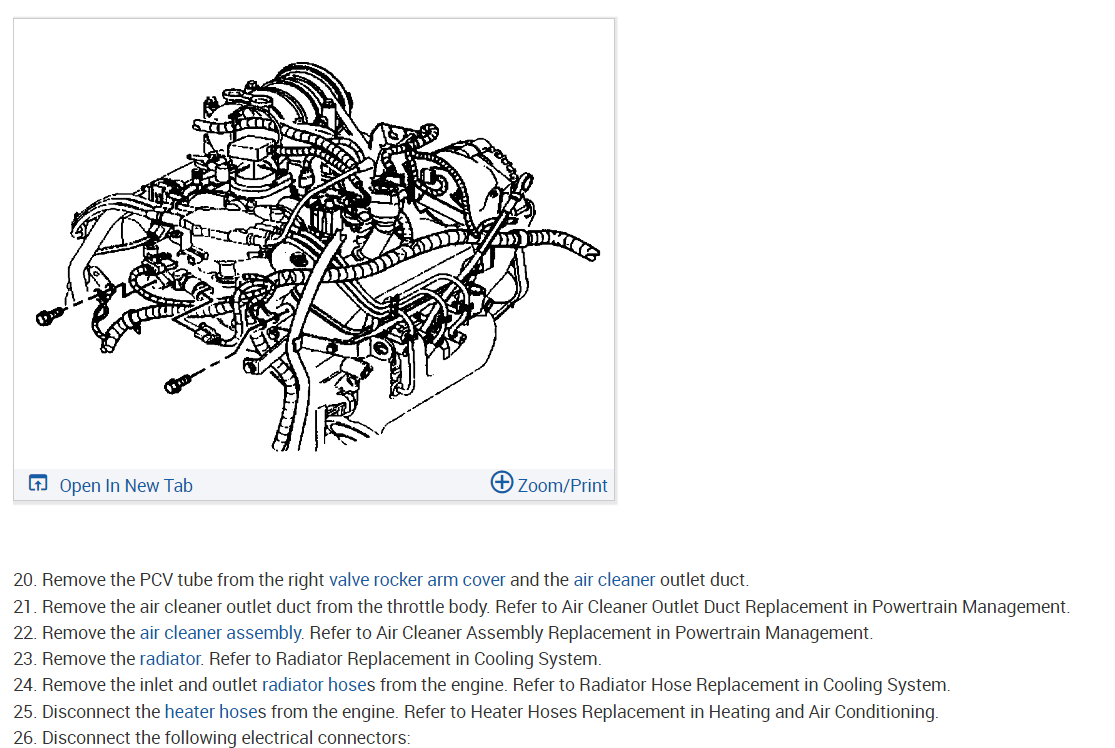

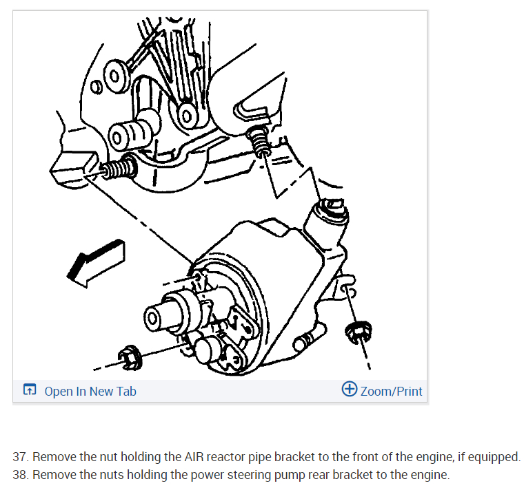

you don't have to remove the front axle,transfer case,or body mounts but you do need to lower the rear of the transmission to get to the upper bellhousing bolts. Here are the instructions on how to get the engine out of the car. Check out the images (below). Let us know if you need anything else.
