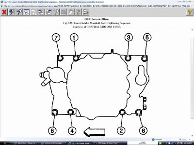

torque values on the intake manifold?
2003 CHEVROLET BLAZER
105,000 MILES • 6 CYL • 2WD • AUTOMATIC
UNCLEBILLY
I was trying to find out the torque values on the intake manifold for the 4.3L V6

Pass one in sequence= 27 lb in pas 2= 106 lb in pass 3= 11 lb ft. Check out the diagrams (Below). Please let us know if you need anything else to get the problem fixed.
