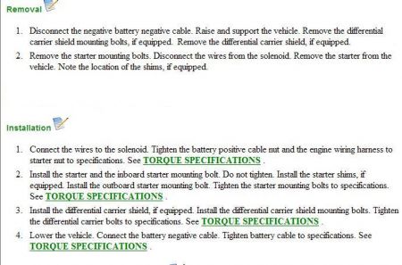

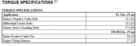

how do you get the sarter out then in again
Tuesday, June 9th, 2009 AT 7:03 PM
BLUELIGHTNIN6
MECHANIC
16,542 POSTS
SPONSORED LINKS
Tuesday, June 9th, 2009 AT 7:14 PM
