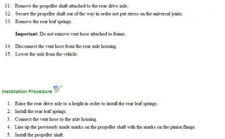

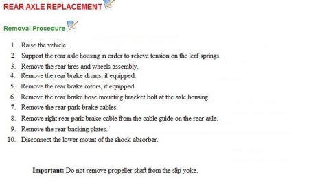

I had a bearing go bad in my blazer, leading to a complete replacement of the rearend. How do I do this? How do I remove one axle? One is bent. Thank you.

https://images.2carpros.com/forum/automotive_pictures/261618_Noname_1292.jpg
https://images.2carpros.com/forum/automotive_pictures/261618_Noname2_386.jpg
https://images.2carpros.com/forum/automotive_pictures/261618_Noname3_147.jpg
