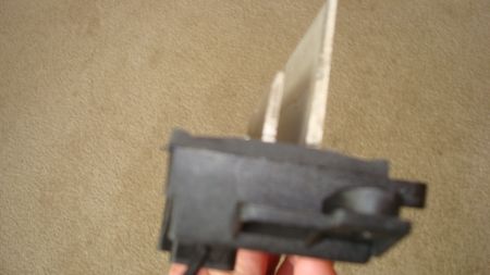

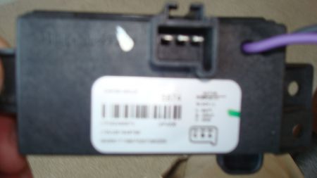

LKNOTT34
  • 6 POSTS
Do I have the correct part??
https://images.2carpros.com/forum/automotive_pictures/359670_DSC03797_1.jpg
https://images.2carpros.com/forum/automotive_pictures/359670_DSC03799_1.jpg
Jun 6, 2010 at 6:38 PM

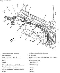

  • 75,992 POSTS
Look at the pic below-there's a connector-which is for the blower motor speed controller at no.12 verify the connector to the controller mating surface. If it matches you're on the right track.
