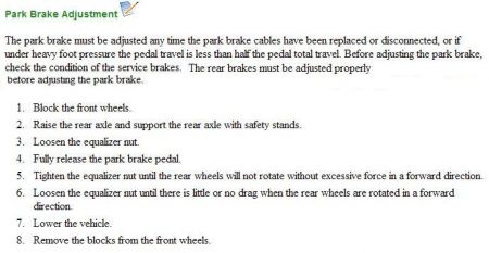

how do I adjust the parking brake?

https://images.2carpros.com/forum/automotive_pictures/261618_Noname_1830.jpg
