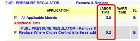

How much should it cost to replace a fuel regulator on a 2001 Chevy Blazer 4wd?
Dec 28, 2020 at 11:40 AM (Merged)
ZACKMAN
  • CAR REPAIR CONTRIBUTOR
  • 4,202 POSTS
https://images.2carpros.com/forum/automotive_pictures/55316_01blazer_1.jpg
Plus cost of part, shop supplies and tax, of course.

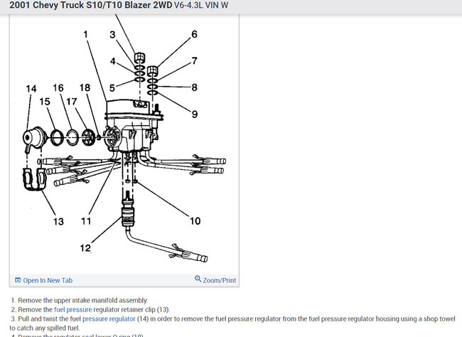

GINAMANFREDO
Engine Performance problem
1999 Chevy Blazer 6 cyl Automatic
I tooked my car to the mechanic two weeks ago. The car had its tune up and a week later, they replaced the gas regulator, because had a gas leak problem. After that the Engine Soon Service light came on. The codes problems are P0171 and P0174, which means the engine is running lean. The mechanic check the vacuum lines, clean the inyectos and clean the oxygen sensor. But the light is still on. Could you help?
Dec 28, 2020 at 11:42 AM (Merged)
MASTERTECHTIM
  • 4,750 POSTS
most likely when he replaced the regulator(which he had to remove the intake plenom) he damaged the intake manifold gasket and he should take care of the repair if he is reputable. let me know how you make out

MARIONRAY
how do i replace fuel pressure on 4.3 vortech engine?
Dec 28, 2020 at 11:43 AM (Merged)
BLUELIGHTNIN6
  • 16,542 POSTS
Properly relieve the fuel system pressure and disconnect the negative battery cable.
Remove the fuel return pipe from the regulator and discard the old O-ring.
Disconnect the vacuum hose from the regulator.
Remove the fuel return pipe clamp.
Remove the pressure regulator attaching screw, then remove the regulator and discard the O-ring.
To install:
If the old pressure regulator is being installed, check the filter screen (if equipped) for contamination and replace, if necessary.
Lubricate the new O-rings with clean engine oil, then install them on the pressure regulator and fuel pipe.
Install the pressure regulator onto the manifold.
Make sure the regulator attaching screw threads are covered with Loctite 262 or an equivalent threadlocking compound, then install and tighten the screws to 31 inch lbs. (3.5 Nm).
Connect the vacuum hose to the regulator.
Make sure the new O-ring is in position, then connect the fuel return pipe to the pressure regulator and tighten to 22 ft. lbs. (30 Nm).
Install the fuel return pipe clamp and attaching nut to the lower intake manifold assembly.
Connect the negative battery cable, then pressurize the fuel system by cycling the ignition (without attempting to start the engine) and check for leaks.

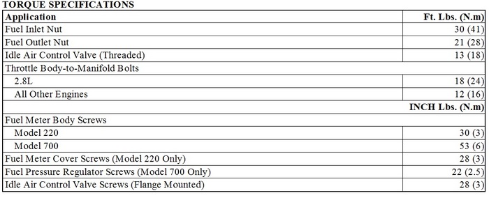

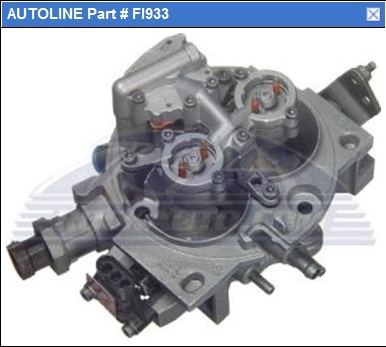

TRASKRIVERJACK
What is the procedure for installing a kit in the fuel pressure regulator of an 1989 5.7 K5 Blazer TBI ?
Dec 28, 2020 at 11:45 AM (Merged)
JDL
  • 16,098 POSTS
Make sure no pressure on system, Remove top torque screws, the autostore sells a fitting to remove those. You should be able to remove only the top part. Picture below.
TRASKRIVERJACK
And then what ? I understand the regulater is under spring pressure. How to disassemble, reassemble, and what are the alignment issues, and torque values for the fasteners ?
JDL
  • 16,098 POSTS
You shouldn't have any problems, just put it back together the way it came off. I don't use a torque wrench on screws that small, maybe I should? Torque specs are below.
