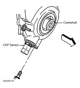

my 2002 blazer has engine light on and had it checked out and it came out as p0304 and sometimes p0300 the wires and sparkplugs were changed fuel filter, pvc valve coil, gas cap, and still gives me the same code I was told to do a compression test and I did only on one side though and the numbers came out to be very similar on the side that the #4 cyl is can you help me out I'm going nuts. the car seems to ride pretty smooth the tachometer doesn't fluctuate at least to my eye.
Nov 12, 2008 at 10:46 AM
DAVE H
  • 13,384 POSTS
try taking out crankshaft position sensor and cleanig .. your getting in intermitent misfire @ 4 cyl this is 4.3L engine

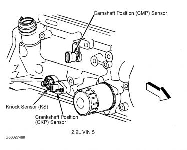

this is 2.2L engine

GUZ0181
Dave H;
Thanks for the advice on removing the CKP Sensor, I did what you suggested and for a lil while I thought that it got fix but I thought too soon the same p0304 code came back. Now I'm really stunned and not knowing what to expect, anything else comes to mind. I really appreciate your advice any more suggestions :)

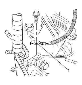

because you said you thought it might have worked i looked TSB's for you .. this could be interesting .. Information on Engine Misfire MIL/SES Light Illuminated or Flashing DTC P0300, P0301, P0302, P0303, P0304, P0305, P0306, P0307, P0308, P0420 or P0430 TECHNICAL SERVICE BULLETIN Reference Number(s): 06-06-04-046, Date of Issue: September 12, 2006 Affected Model(s):1999-2007 Cadillac, Chevrolet, GMC Full-Size Pickup and/or Utility Trucks; with 4.8L, 5.3L, 5.7L, 6.0L or 6.2L VORTEC GEN III, GEN IV, V-8 Engine (VINs V, C, T, Z, B, 3, M, 0, J, R, U, N, Y, K, 8 - RPOs LR4, LY2, LM7, L59, L33, LC9, LH6, LMG, LY5, L31, LQ4, LQ9, L76, LY6, L92); with Active Fuel Management(tm) and E85 Flex Fuel Related Ref Number(s): 06-06-04-046 ARTICLE BEGINNING SERVICE INFORMATION If you encounter vehicles that exhibit the above conditions, refer to SI for the appropriate DTC(s) set. If no trouble is found, the cause may be due to an ECM ground terminal that has corroded with rust over time. Inspect the main engine wiring harness ground terminal (G103) for this condition. The wire terminal (G103) attaches either to the front or to the rear of the right side cylinder head, depending on the model year of the Full Size Pickup and/or Utility Trucks. If the ECM ground terminal has been found to be corroded, then follow the service procedure outlined in this bulletin to correct the corrosion issue. Fig. 1: Engine Wiring Harness Ground Terminal Location (2007 Full-Size Pickup and/or Utility Trucks) Courtesy of GENERAL MOTORS CORP. Fig. 2: Engine Wiring Harness Ground Terminal Location (1999-2006 Full Size Pickup and/or Utility Trucks) Courtesy of GENERAL MOTORS CORP. Remove either the nut or bolt securing the main engine wiring harness ground terminal (G103) to the right cylinder head. Refer to the above illustration to determine where the ground is located on the vehicle (1). Remove all rust from the ground terminal, the cylinder head and the retaining nut or bolt. Position the main engine wiring harness ground terminal and install the nut or bolt. Tighten:: Tighten the retaining nut or bolt to 16 N.m (12 lb ft). Apply some type of electrical moisture sealant to protect the harness terminal from further corrosion.
