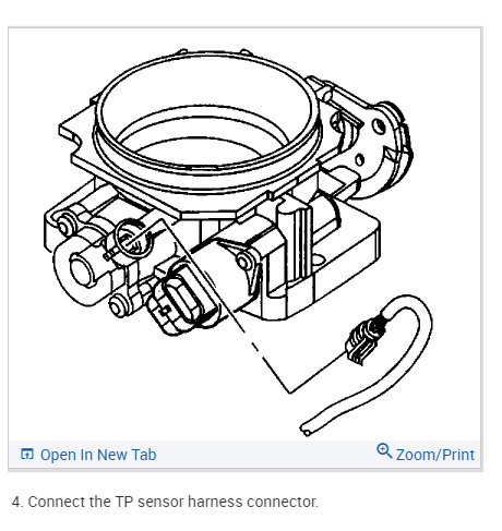

where is and how do you replace a throttle position sensor?

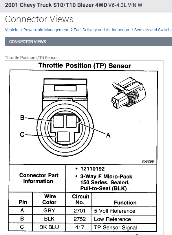

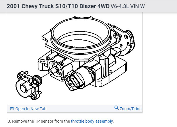

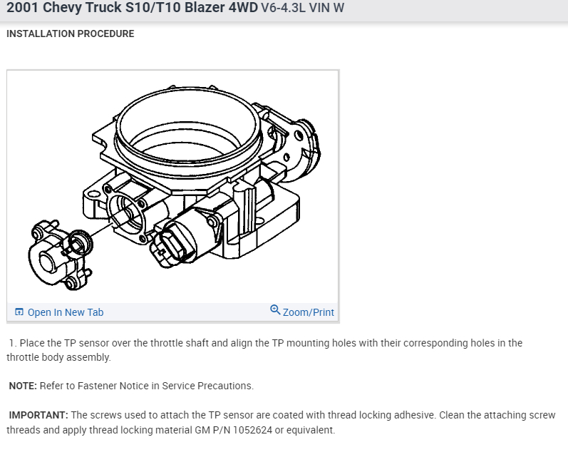

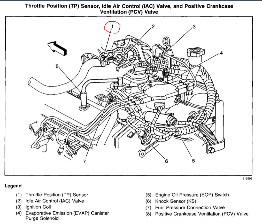

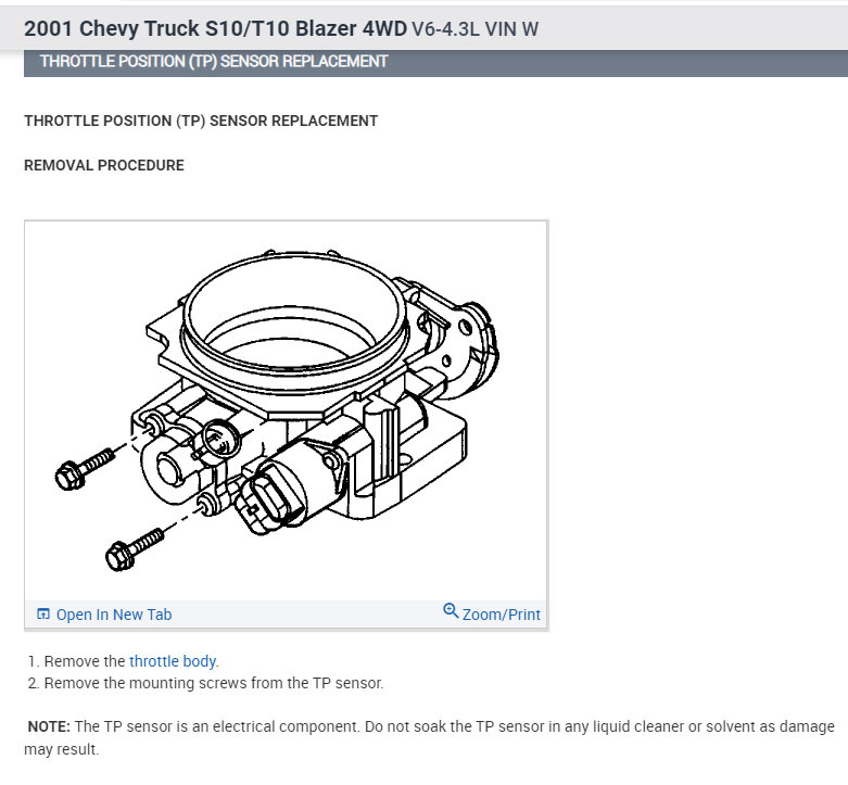

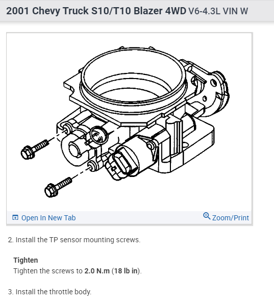

The throttle position sensor is located on the throttle body. Which is located on the top of the engine at the end of the air intake tube.
The throttle position sensor is mounted on the throttle body with 2 screws.
I have attached the diagram showing the location as well as replacement procedure below.
