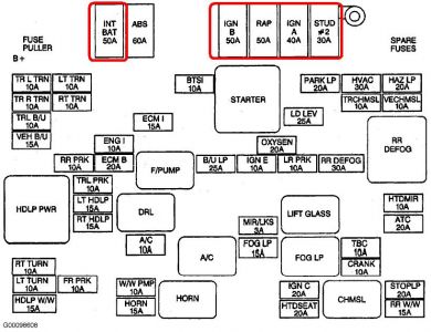

Hi.My wifes S10 Blazer wouldn't start.I tried jumping it.That didn't work. I had her turn on the lights,nothing. None of the dash lights come on or headlights. I had the battery checked under load and it checked out "Good". I put the battery back in checked the cables,their good.Still no lights or anything.

When you said the dash didn't even come on, I suspect your main fuse under the hood is bad.
https://images.2carpros.com/forum/automotive_pictures/55316_00blazerfuse_1.jpg
Check the red circles, and other fuses marked IGN

Thanks for the answer and diagram.The problem was the positive battery cable.Funny how a little crud can ruin a perfectly good day.
Thanks again and god bless.
