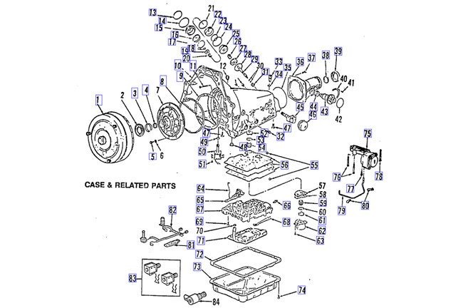

Intermitent Problem: Speedometer reads zero, ABS light comes on, and Brake light comes on, and the transmission won't shift out of first... All this ponts to one thing: Vehicle Speed Sensor. My question is this, being that it's only happening intermitently, is it more likely to be the sensor, or the wiring. And, how would I trouble shoot the sensor.
Mar 22, 2009 at 3:32 PM
BUDDYCRAIGG
  • 2,262 POSTS

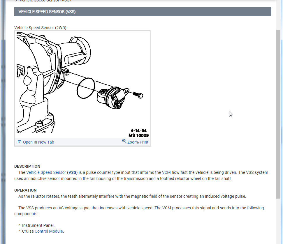

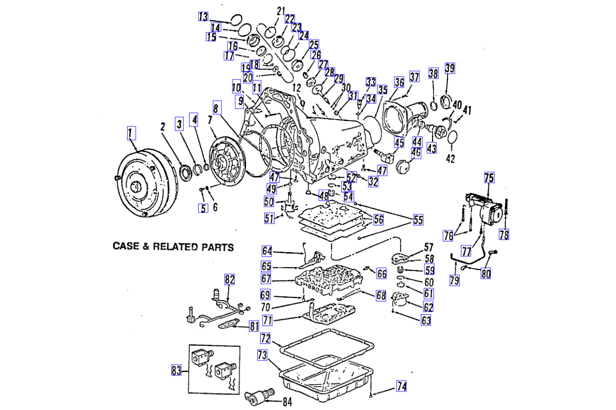

It sounds like the VSS is no good here is the location in the diagrams below #43. Check out the diagrams (Below). Please let us know what happens.
Mar 22, 2009 at 6:35 PM
EVIL_JARED_MN
that fixed it thank you.
Mar 23, 2009 at 5:24 AM

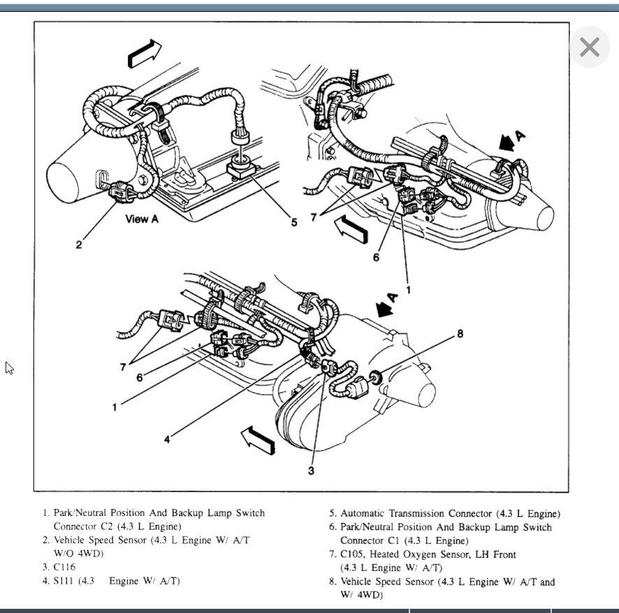

Here are a couple more views of this as it gives a little detail of 4WD vehicles and 2WD if you have that. Please let us know if you need more info. Thanks
