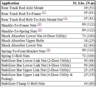

how tight do i need new sway bar end links????

https://images.2carpros.com/forum/automotive_pictures/55316_00blazerrearsusp_1.jpg
