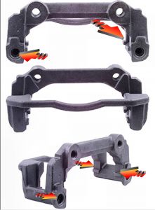

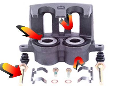

For what it matters...These are the spots I like to cover with lube:
https://images.2carpros.com/forum/automotive_pictures/30961_caliper_lubeareas_13.jpg
https://images.2carpros.com/forum/automotive_pictures/30961_caliper_lubeareasbrack_13.jpg
If you used a proper grease on these areas, then I would nect look at glasing on the pads and rotors. Some are more susceptible to a glazed surface. Which can be sanded off sometimes.

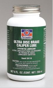

https://images.2carpros.com/forum/automotive_pictures/30961_caliper_lube_14.jpg
I am VERY partial to this kind of lube myself.
