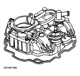

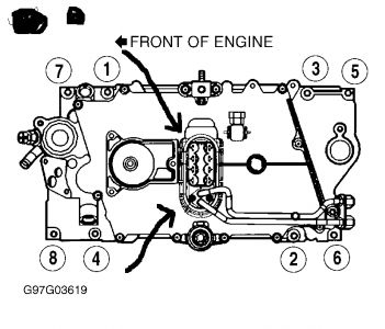

BMRFIXIT
  • 19,053 POSTS
Pcm &engine control module are the same
its the vehicle computer ,center command ,the brain . . .. . .
if dealing with one cylinder misfire code P0301
PCM is getting no power reading out of the cylinder
in return will turn on check engine light on
you had a compression done and its good
checked and clean the injector and they good
you need to verify that spark is on that cylinder and strong
remove the wiring harness injector plug and verify the all injector pins OK and none was bent or broke
https://www.2carpros.com/forum/automotive_pictures/99387_Graphic1_206.jpg
https://www.2carpros.com/forum/automotive_pictures/99387_Graphic2_97.jpg
