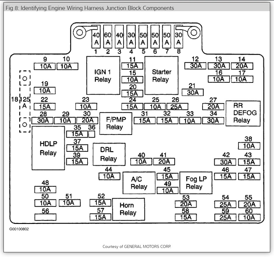

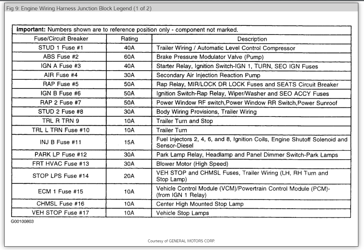

Its the ECM B fuse 20 amp in the under hood fuse block that powers the fuel pump thru the fuel pump relay. Here is a guide to help test it with the fuse locations as well in the diagrams below.
