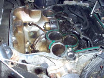

I have an 02 blazer, it would stall while driving, just quit. I replaced 2 fuel pumps in 6 mos. The car would hesitate prior to stalling. I put fuel injector cleaner in the gas and it ran for about 2 weeks when it stalled again yesterday. It seems that if you let the car sit for awhile and cool down it will start and run again. This is and intermittent problem. After talking to several people I was thinking of replacing the fuel pressure regulator but I cannot seem to locate where it is. I have asked at auto zone and Murrays and they cant find it either. Can anyone tell me where to find it and how to do it? Thanks
Jun 29, 2008 at 6:06 AM
OBXAUTOMEDIC
  • 3,711 POSTS
To find the fuel pressure regulator you will have to take the Plenum off...... it is located in the center of the picture....
https://images.2carpros.com/forum/automotive_pictures/188069_IM000109_1.jpg
If I may ask were do you live, I ask because you mentioned Murrays....

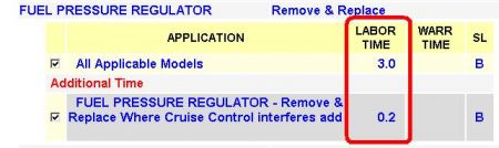

How much should it cost to replace a fuel regulator on a 2001 Chevy Blazer 4wd?
Dec 28, 2020 at 3:40 AM (Merged)
ZACKMAN
  • 4,202 POSTS
https://images.2carpros.com/forum/automotive_pictures/55316_01blazer_1.jpg
Plus cost of part, shop supplies and tax, of course.

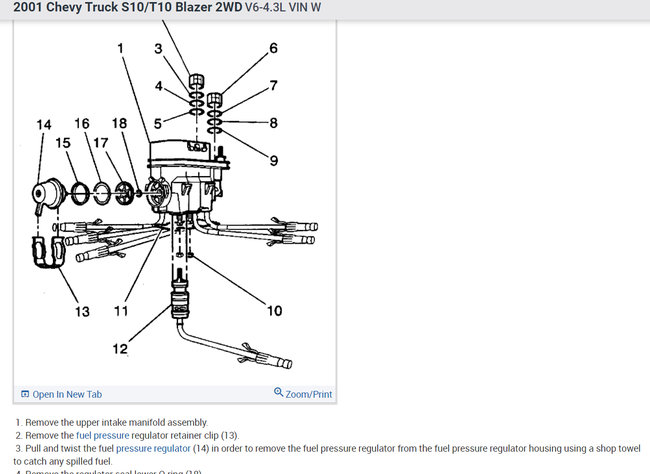

DEAD01BLAZER
Got a 2001 Chevy Blazer, 4.3 Vortec 6cyl. csfi Where exactly is the fuel pressure regulator located? Cant seem to find visually Dont see exposed fuel rail Do i have to remove the intake manifold? Can take a picture of engine if that would help of course its snowing now!!!
Dec 28, 2020 at 3:41 AM (Merged)
MOHMAN
I have a 4.3 6cyl. 2000 chevy blazer with the vortec. The regulator I hate to say is under the manifold with the spider injector. Im having the same problem with mine. The engine cranks but wont start. The pump is working and the filter was changed. Good luck Ive learned my lesson with this Chevy. Here are diagrams to help you see what I am talking about. Check out the diagrams (Below)

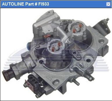

30YRNAVY
Hello, this is my first post in this forum and I hope that someone can help with my problem. I feel I'm a capable backyard mechanic so asking the following question is sort of like being lost and being forced to ask for directions...a bit embarrassing! Anyway, my son just purchased a 1993 Chevy S10 Blazer, 4.3 engine, 4WD, automatic with 125,000 miles. It runs very rough and has a strong smell of gas. I changed all plugs, wires, distributor cap and rotor. Still runs rough. Upon removing the plugs I noticed that all three plugs on the drivers side of the engine were black with soot. The three on the opposite side looked normal, if not overly white. I realize I have a fuel injection problem, but what in the injection system would effect only the one side of the engine? Could a Fuel Pressure Regulator be the culprit and is this something I could replace? Thanks for any info you can provide. Bill
Dec 28, 2020 at 3:44 AM (Merged)
2CARPRO JACK
  • 11,533 POSTS
93 CPi's had other problems beside the regulators.The fuel lines in the intake have been known to pinhole, causing raw fuel to be sprayed into the intake plenum. The lines are on the d/s , so I would suspect that could be the problem. Remove upper plenum, and turn key on, but DO NOT CRANK, if any fuel leaks they will be readily visible

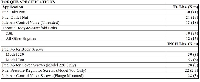

TRASKRIVERJACK
What is the procedure for installing a kit in the fuel pressure regulator of an 1989 5.7 K5 Blazer TBI ?
Dec 28, 2020 at 3:45 AM (Merged)
JDL
  • 16,098 POSTS
Make sure no pressure on system, Remove top torque screws, the autostore sells a fitting to remove those. You should be able to remove only the top part. Picture below.
TRASKRIVERJACK
And then what ? I understand the regulater is under spring pressure. How to disassemble, reassemble, and what are the alignment issues, and torque values for the fasteners ?
JDL
  • 16,098 POSTS
You shouldn't have any problems, just put it back together the way it came off. I don't use a torque wrench on screws that small, maybe I should? Torque specs are below.
