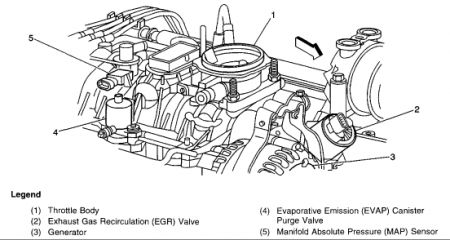

just wanted to know where canister purge valve is located on my 2000 chevy blazer trying to change it but cant see where it is located
