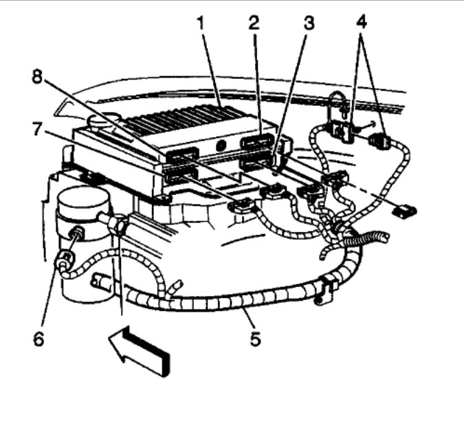

2000 Chevy Blazer 6 cyl Two Wheel Drive Automatic
Ac blowing air, full of freon but compressor not coming on!
Aug 1, 2009 at 9:04 AM
  • 110,244 POSTS
This sounds like you have a low side pressure switch that is out lets test it by connecting the wires together and see if the compressor comes on.
Here is a guide to help as well.
Here is the pressure switch location #6 Check out the diagrams (Below). Please let us know what happens.
