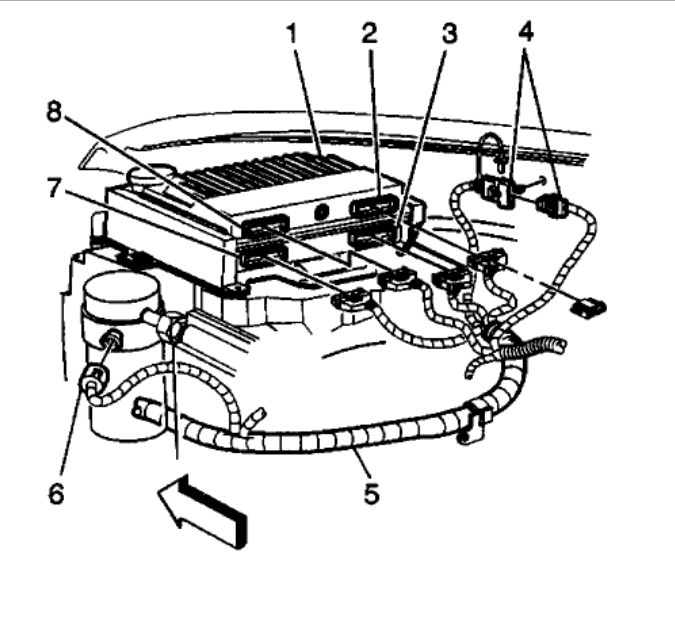

Ac blowing air, full of freon but compressor not coming on!
Saturday, August 1st, 2009 AT 4:04 PM
MECHANIC
110,029 POSTS
This sounds like you have a low side pressure switch that is out lets test it by connecting the wires together and see if the compressor comes on.
Here is a guide to help as well.
Here is the pressure switch location #6 Check out the diagrams (Below). Please let us know what happens.
