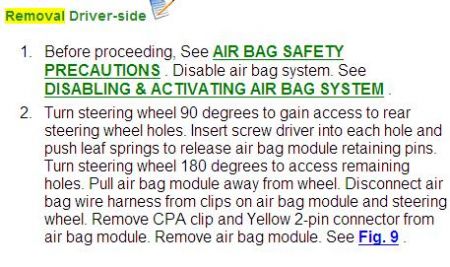

Having problem I'm replacing turn signal. Have trouble take off the airbag. Behind the steering wheel I was able to remove one T-20 screw on each side. Can't figure way airbag to give. Please help. Yes airbags are disconnect battery and fuse.

Hi, thanks for the donation. Some automotive forums won't talk to you about airbags, because of safety issues. If it blows-up in your face, that's on you, not us. I found this procedure in MOD. If the info doesn't help, I'd have to look at it.
https://www.2carpros.com/forum/automotive_pictures/170934_airbag_2.jpg
