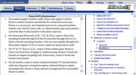

It appears that the starter on my 1999 S-10 Blazer has room to be removed between the bell housing and lower A-frame, but is there a secret to ease the removal? Are the electrical connections standard?
Apr 17, 2008 at 6:08 PM
  • 75,992 POSTS
For Blazer see below
