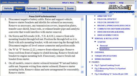

It appears that the starter on my 1999 S-10 Blazer has room to be removed between the bell housing and lower A-frame, but is there a secret to ease the removal? Are the electrical connections standard?
Apr 17, 2008 at 11:08 AM
  • 75,988 POSTS
For Blazer see below
https://images.2carpros.com/forum/automotive_pictures/12900_S3_1.jpg
