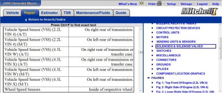

I,ve been trying to locate the speed sensor on my 99 chevy 4 door 4wd blazer all day, my blazer has plastic bruss guard under it and I have back issues that prevent me from being under thier for very long. pictures on the internet I,ve found are less than helpfull. I know the sensor is bad and just want to replace the darn thing. please help!

See below
https://images.2carpros.com/forum/automotive_pictures/12900_vss_23.jpg
